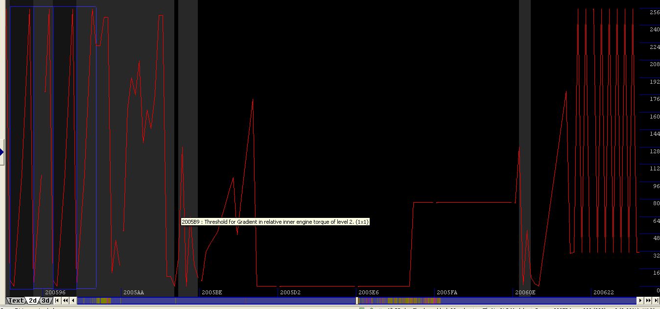

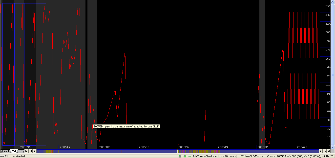

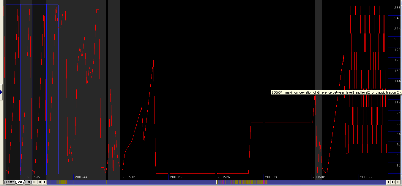

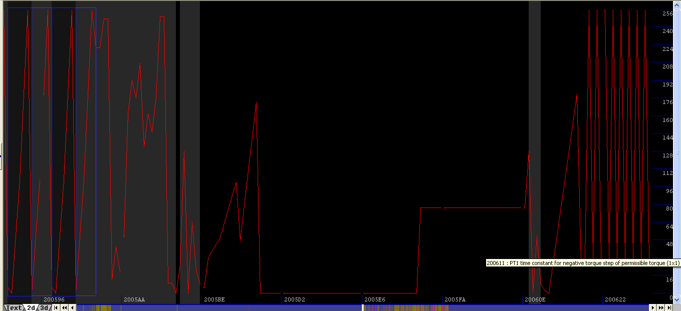

PT1 time constant for negative torque step of permissible torque 8 bit eeprom x 1
maximum deviation of difference between level1 and level2 for plausibilisation 8 bit eeprom x 0,390625
permissible maximum of adapted torque 8 bit eeprom x 0,390625
Threshold for Gradient in relative inner engine torque of level 2. 8 bit eeprom x 0,390625
